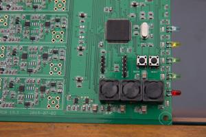

Hey Everyone,
I have a System Blue (PCB 19.3).  The system does not seem to be working.  I have everything soldered up according to the instructions... When I plug it in the following happens:
- Solid Red Power Light on main PCB.
- Solid Light on both E and H field boards.
- GPS light (on PCB, not the blue LED soldered on) blinks like 7 times and just then off.
I have a grounding clamp connected to the outside of the RG6, seemed a good place to ground.
That's all that seems to happen.  LAN is not active (no lights on router or PCB RJ45 network connector).
Is this normal? If I have bad GPS reception (this is on my work bench in basement) will the unit fail to boot?
Thoughts?
Confused

5V power supply is 1A and measures 5.08V. The 3.3V measures in at 3.27V. Should be good to go. Upon further inspection I found that I am missing the R825 resistor. Looks like it should be 1k ohm. Was this intentional? Could this be causing it? Looks like it is on one of the USB data pins...
Edit: Also, not planning to keep GPS in basement, but I want to get this thing running before I go on a wire fishing expedition. I wouldn't think a GPS fix would be necessary for this to boot, pull an IP, etc.
Edit 2: Thanks piepants. Getting pretty late here (US East). Going to shut it down and try to flash tomorrow. I am concerned about the missing resistor. Can you check your 19.3 to see if yours is there? I may need to solder one on...

I had contacted Egon (THANKS EGON!!!!) and he pointed me at the crystals. I had to swap the crystals during assembly (since I had put them on backwards before noticing they were different) and in the process damaged the 8MHz crystal.  I ordered another, and swapped that out.  Works now 100%
Thanks everyone for tips and tricks.  I am sure I will be back in the antenna deployment stage with more questions!
