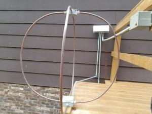

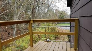

Nice lightning photos you have on Flickr! Do you have some of your antennas and their surroundings?

Like you noticed I'm on the 1st gen system green.  My max distance strike is about 5200 miles (8500 km).  I have to manually switch it with jumpers.  I switch between 11 and 28 on the gain, any higher than 28 I pick up so many strikes it goes into interference mode.  Plus I try to not send tons of unusable data and usually keep it on 11.  When there is little lightning in America I can see that I'm picking signals up in Europe and Australia, but the don't register since they are out of my region.  I attached the only pic of my antenna I could find real quick.  I started years ago so I could see if there was enough lightning in storms to bother trying to photograph.  Pretty neat hobby too.
