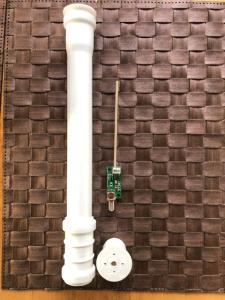

I plan to get some stuff for sealing the boards before sending them outdoors I think its called an Acrylic Conformal Coating.

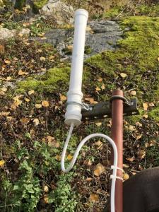

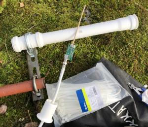

I'm not a big fan of metal poles or clamps for the efield assy.... especially if a metal mount is grounded, and/or there is electrical noise in area. Remember, it functions best on capacitance between probe and earth. Mine are on fiberglass, simply taped to the mast. https://forum.blitzortung.org/showthread.php?tid=2749
Suggest use "Stuf" inside the coax connector. |
