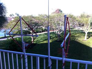

I have designed my antenna as a 2-foot pvc loop antenna with 25 turns, 22gauge stranded
wire and gain set at preamp of 43x Gain. Channel A,B jumper set on pin 2.
The preamp board is PCB 5 version 7, Data board PCB 6 version 8.
