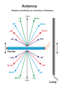

Short answer - NO!
Second Amplifier should be a E-Field
Diagram showing ONE antenna
