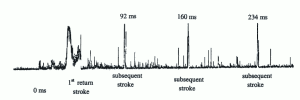

Another Idea to save traffic/overhead and reduce server load:
A lot of strikes have subsequent strikes following within miliseconds:
Maybe you can pool multiple signals together and only send data for example once every second.
RE: Decrease data usage with Blue hardware - Eric.Wouters - 2016-01-24
mmm see the idea but what if we have a heavy storm with many strikes ... stations nearby won't be affected since going into saturation. But those that are at good distance for triangulation with precision ... imagine they all miss a few strikes due to this, in the end you won't ever have enough data for triangulation since each station will miss a few peaks but not necesarely the same ...
my 2 cents
RE: Decrease data usage with Blue hardware - Steph - 2016-01-24
I don't ment to throw away signals, but to pool them, so there is less IP/UDP overhead and the compression may be more efficient.
RE: Decrease data usage with Blue hardware - Tobi - 2016-01-24
Pooling needs memory and the controller has very less memory. Saving a few bytes by reducing the overhead is not worth the memory. That's why we send the signals out as quickly as possible to have space left for the next ones. If not, then this will generate an overflow which you can see on the top of the status page.
