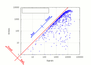

My proposal:
For each range (50,500,5000)
Red axis * (Blue axis * emphasis factor)
emphasis factor since red axis is more important than blue axis.
(Station_Strikes / Station_Signals) * ((Total_Strikes / Station_Strikes) * Emphasis)
But is it really a problem? I think a team member could contact those 5% that are very bad.

Steph,
it's not possible, to go "over" the red axis. If this happens, a station would detect more than one strike with only one signal !
But an good idea. Maybe we can set the emphasis factor dynamically, if me measure/calculate the distance a station (strike/signal) to the red axis. If I know well, i'ts is called "normalization". But we also should take care of the number of detected stroke a station have, too.
Let me do some experiences
Thomas

(2015-07-23, 11:13)Knickohr Wrote: it's not possible, to go "over" the red axis. If this happens, a station would detect more than one strike with only one signal ! Yes, the red axis has a maximum value of 1.
(2015-07-23, 11:21)Tobi Wrote: The results would be much more realistic, if we would measure the strike current and correlate it with the signal strength and distance of the station. That's possible, but so far I hadn't the time to implement the algorithm for that.
Would be very interesting. But could also be difficult, because the EM-Field isn't radiated and propagated isotropic. While the propagation can be estimated with a bunch of formulas, the radiation pattern is more or less random. Though, it differs only a few dB.
And it would only adress the sensitivity, not the SNR.

Hmmm ...
(Station_Strikes / Station_Signals) this is the red axis
(Station_Strikes / Total_Strikes) this is the blue axis
(Station_Strikes / Station_Signals) * (Station_Strikes / Total_Strikes) this is the efficiency in lightningmaps.org !
Maybe we have to put some weighting to this both axises ?
For example :
( 2x (Station_Strikes / Station_Signals) + 1x (Station_Strikes / Total_Strikes) ) /3 *100
This will double the weighting for the location ratio.
Hmmm, looks like every station is efficient
Edit : Played a little bit with the weighting and found, the best weighting is NO weighting (see plot)  The only different now is the + operator, not using the *
Thomas
