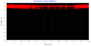

Here you go.

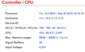

It seems lower on that than it does from the controller status page. I wonder why this is? Is this too low? Their website says output voltage is adjustable, but I'm not sure about that.

Thanks, quite nice graph Smile
This is mine - terrible Angry (Scale of 0.5V - just like you).
Different voltages: CPU, Input Voltage.
At least you aren't under power, but I don't know if over is good either... I wonder if it makes any difference?

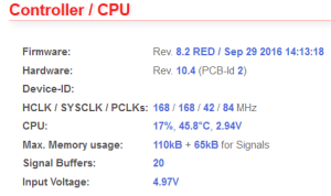

don't let it go over about 5.25....If I'm below about an indicated signals page voltage of 4.65-4.75 something is likely amiss... not enough current from wall wart, or at the margin, for example.  if you've got a good, current rated supply, it should regulate at source fine.
See the specs on that 1898.... the source input on my BLUE at 115V right now is showing 4.95 volts with DVM, signals page is indicating 4.55...   (i've a pre-release controller with piggy-back power supply mod board hung on... ).... My Red is on the button at 5.0 source, and 4.75 on signal page.
