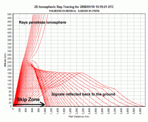

Which layer of the ionosphere do 16 kHz signals bounce off of?
Also, the idea of a skip zone at such low frequencies is new to me! They are almost unheard of at 2 MHz, and more common as you go up in frequency, depending on the time of day and solar activity.

(2018-11-08, 05:23)mwaters Wrote: Which layer of the ionosphere do 16 kHz signals bounce off of?
Any layer or height it wants to.. I suppose.. what does your research show? Lower freqs bounce. Higher Freqs escape.
You could assume D layer... E maybe at times... I'm an operator, Jim, .. not a physicist.... but, conditionally, the others also have some say about it. maybe 40-80 miles, whichever is currently 'in charge'... pun intended.
Also do NOT forget: THE EARTH is the other 'wall' of the wave guide! It makes stuff bounce too.
Unheard of? You've never listened to a distant am radio station fade in and out?

Hi Mike and Cutty, During the night time there is no "D or E Layer," only "F" Layer.
During the Daytime it is possible, due to ionisation density variations, to have Sky wave signals at VLF and ELF from all three and possibly four ionised layers ("D, E, F, or F1 and/or F2,) simultaneously or at varying intervals.
Theoretically it is possible to have Sky wave propagation without contact with the ground for considerable distances, especially where there is a transition from day to night, night to day, Chordal Hop and Grey line effects.
Neither the Ionosphere nor the Earth are smooth flat surfaces, nor perfect curves, so there are various forms of Diffraction, Refraction, Absorption and Scattering etc., and other natural phenomenon, (Aurora? Non Great circle paths, due to ground wave becoming sky wave or vice-versa) that may account for fading or enhanced propagation at varying distances and for the different frequencies in the bandwidth of a stroke of lightning.
There possibly could also be considerable time differences for the same stroke, if there is long path and short path propagation, at the same time, or multiple around the world paths, as in near antipodal situations.
While this probably does not make things much clearer in regards to our case, there have been many studies done with ELF propagation for submarines.

I found this ELF propagation link from sferics.com and plan on studying it a little. The goal is to find out whether a skip zone exists at ~16 kHz.

Thanks, Mike. I've studied the first one and did brief searches through the other two just now.
One thing to consider is that diagrams imply that there is a single takeoff angle from a strike. The reality is different.

Right or wrong, https://en.m.wikipedia.org/wiki/Skip_zone seems to imply that there is no skip zone at LF.
"A method of decreasing the skip zone is by decreasing the frequency of the radio waves. Decreasing the frequency is akin to increasing the ionospheric width. A point is eventually reached when decreasing the frequency results in a zero distance skip zone. In other words, a frequency exists for which vertically incident radio waves will always be refracted back to the Earth. This frequency is equivalent to the ionospheric plasma frequency and is also known as the ionospheric critical frequency, or foF2."
