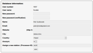

Greetings,
Can not assign new station to user database information page.
After hitting SAVE station ID disappears.
Stations: 2629
Stations: 2629

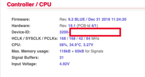

your id is the long long number as shown in picture
(2019-12-15, 15:15)Eric.Wouters Wrote: your id is the long long number as shown in picture
Thank you,
That solved the problem.
It should say: Device-ID not Processor-ID in the Database information entry form.

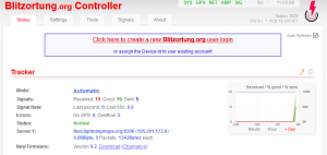

station not on list or map fully JERSEY CHANNEL ISLANDS UK
station 2712
ID 2087
and no 1pps gps fault
(2020-05-31, 10:21)GJ7DNI Wrote: station not on list or map fully JERSEY CHANNEL ISLANDS UK
station 2712
ID 2087
Detector 2712 has not send any data up to now.
