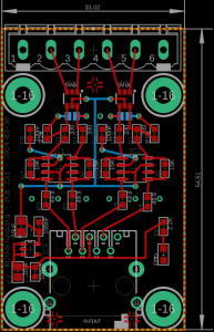

New user - numbNinja - 2025-08-28 Hello, station 3212 here. Could I kindly have my status updated to 'participant'? I have been tuning over the past few weeks, and think I have things mostly dialed in. Things appear stable, but will continue to play with things. I think the question I have for the moment is why the website only shows one antenna input when I have confirmed that the station appears to be participating in stroke location with either of the inputs disabled at the amplifier. Both inputs appear to be functioning fine with regard to signal detection on the local interface, detecting strokes, and uploading to the server. I have attempted to search the forum, for solutions, but perhaps I will be able to glean more info after user enablement, as some posts appear to not be readable by my account in the current state. ![]() Any insight? Kind thanks, and happy to be participating! RE: New user - numbNinja - 2025-09-01 Thank you for updating my status. From I have gleaned with the additional access is that this channel is not detecting properly. I shall troubleshoot. If I have any additional questions in this regard, I shall post them to 'internal'. Thanks goes out to the mods for adding me so that I could read.
