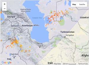

I know have Ch1 loop with it's null aimed to get minimum Anthorn/Skelton, which means it's lobes are almost exactly N/S. Gain is normally 2560 with 50 - 60 mV "noise". Ch2 loop looking NW/SE as far as it can go W/E without Anthorn/Skelton being so F***ing loud they constantly trigger the system, that means about 200 mV p-p unfiltered. I filter this channel at 17 kHz which brings that down to the 50 - 50 mV range with a gain of 4000. This is the only channel I have a filter in.
The system seems to be working very well. Yesterday there were many in the western end of Iran and the area where Turkmenistan, Uzbekistan and Kazakhstan all meet the far side of the Caspian Sea. That's 2,700+ miles (4300+ km). See attached:
  • Time range: from 2016-11-01 00:00:00 UTC to 2016-11-02 00:00:00 UTC
  • Count: More than 1000 Strokes found
  • Oldest: 2016-11-01 10:40:57 UTC
  • Newest: 2016-11-01 23:58:31 UTC
Participated strikes are marked with a large square blob with a light center, just detected are small round blobs. The shaded/unshaded is the boundary of the 3000 mile search radius. That map is a capture from my install of MyBlitzortung which I think only has strike information relating to my station.
I'm not sure I believe the few participated and other strikes that show up south of the equator off the coast of Congo/Angola! They are 4,200 miles (6,700 km) away... Is there a way to verify them?
