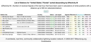

Hi Joe et al: We were in South Carolina for the eclipse, so I shut down the station as I could not get the noise level down. I moved everything into another room of the house, and it seems better. If you have a chance would you take a look at my graphs and tell me what you think.
Steve
Stations: 1964
#27
I think it's looking pretty good! Right now, your station is performing better at medium range strikes than all the others in Florida. Nice!
Stations: 1955
