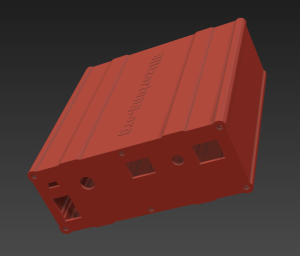

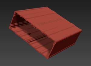

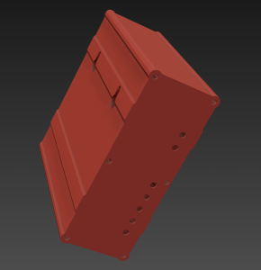

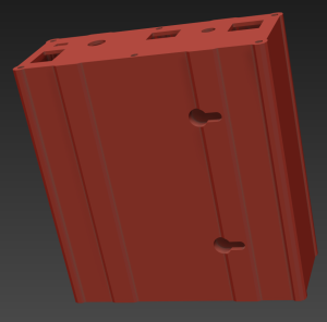

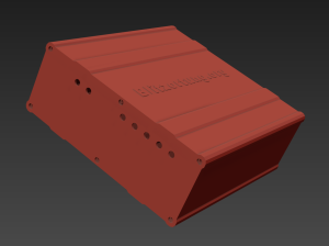

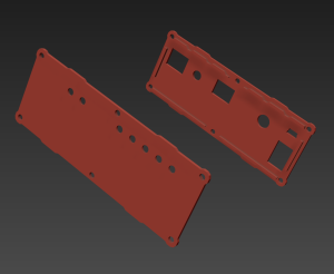

Hello.
I developed a housing model for 3D-print. Today upload it on the thingiverse. The link will be a little later.

#33
looks great, thanks for sharing  Shy
