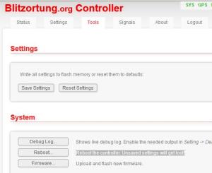

The web interface is what you see when you log on to the controller.
Tools page. Firmware.
Did you download the version 9.1?

I can download 9.1...it appears as a .bin file
But I do not have any Tools page....in my controller page..
I have login, Status and About.....those are the only tabs at the top of the page

Posts: 650
Threads: 5
Joined: 2017-11-24
(2018-12-04, 02:49)Mike Wrote: I can download 9.1...it appears as a .bin file
Station 0
FW 9.0b1PCB 19.4/H1/E1
SYSGPSNETAMPSIG0/s00:00:46
Login
Status
About
Auto Refresh Can you post a screen shot?

Auto Refresh Can you post a screen shot? This is what mine looks like

The problem is that you have enabled "Need Authentication" under Web Interface in the settings tab and you are viewing the Status page as a guest - in other words you have not logged in to your controller yet so most stuff is hidden including the Device ID numbers you need.
To make this work, you need to press the Login link and then login using the username and password you created initially. Once you're logged in you will be able to view the Device ID numbers you need. Unless you specifically want to user that login facility, you can disable the "Need Authentication" . Most of us don't have it enabled as we don't have our controller's status page exposed to the internet using port forwarding.
