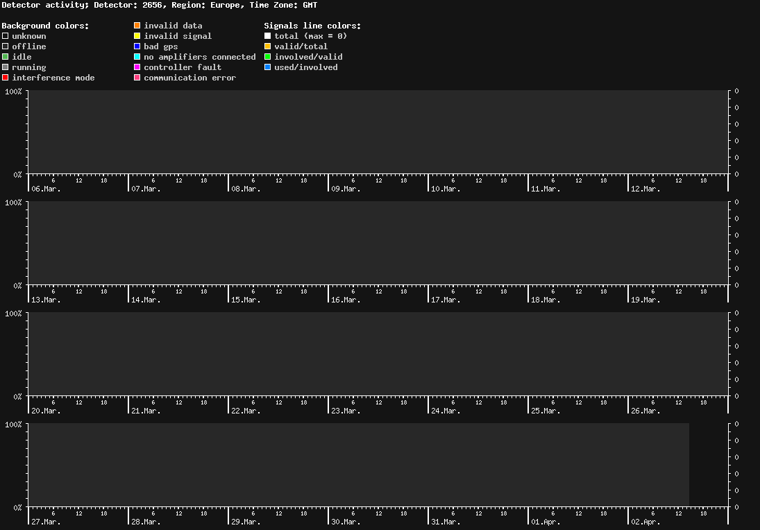

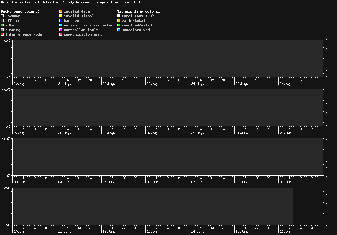

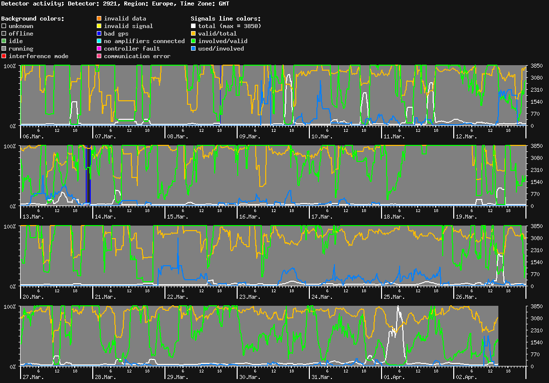

I am currently developing a new image for the detector data with statistical informtion of the last 4 weeks. The image should help to recognized interference times and other probems.
Here is an exampl of my detector
https://map.blitzortung.org/statistic_1....omposed=10
Parameters are
station
region
minutes_composed
Greetings,
Egon

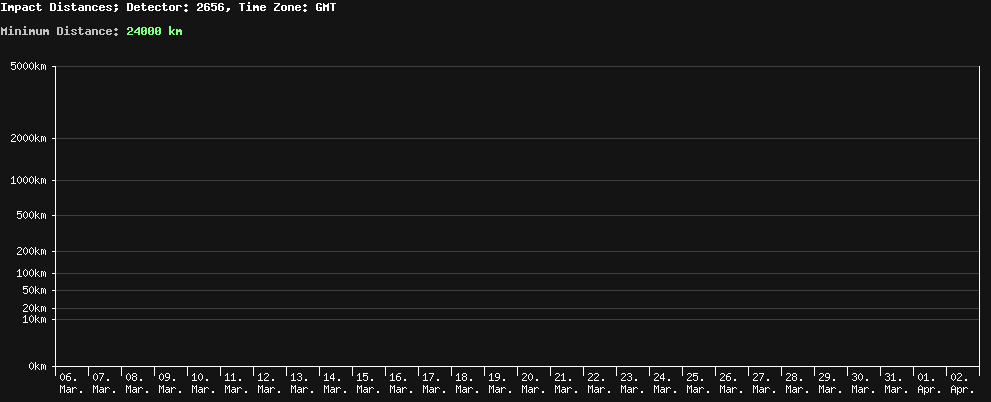

The following picture visualizes the minimum and maximum distance of the detected impact locations. The parameter specifies the station.
https://map.blitzortung.org/statistic_2....&bar_sep=4
Parameters are
station
drawing_area_height (0 - 1000, default 300)
bar_width (0 - 100, default 25)
bar_sep (0 - 100, default 4)
days (1-28)
By the way, in the first graphic I have fixed some bugs.

I notice that intermittently the data displayed on these graphs goes haywire.  At first I thought it was just my station but many others are also displaying this anomaly.  This morning around 0930 (local time, eastern Australia), 2330 UTC, I noticed that the network indicator was flashing on my receiver/controller.  Inspection of http://en.blitzortung.org/station_list.php showed it to be still online and sending data albeit way down in the list and the graphical data was exhibiting the haywire behaviour.  I presume something is going on server side but I'm curious to know whether this is part of a maintenance/upgrade process or a fault.  It's also probably not out of the question that it's a firmware bug.  I am running version 9.2 on a Blue unit V19.1.
Stations: 1527
