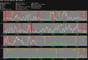

I am currently developing a new image for the detector data with statistical informtion of the last 4 weeks. The image should help to recognized interference times and other probems.
Here is an exampl of my detector
https://map.blitzortung.org/statistic_1....omposed=10
Parameters are
station
region
minutes_composed
header_line 0/1 switches the heading off / on
header_text 0/1 switches the color explanations on / off
drawing_area_height 1-300 defines the scale height.
weeks 1-4 limits the display to the last weeks
time_zone -11/12 adjust the rtime scaling to local time
background_transparent 0/1 set background color to transparent
Greetings,
Egon

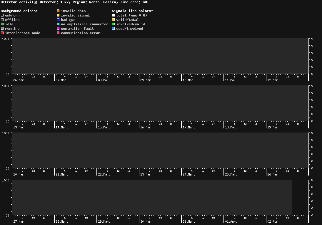

(2020-02-09, 02:50)dupreezd Wrote: By modifying the URL for my station and region, I was able to view my graph.
Sure enough!
https://map.blitzortung.org/statistic_1....=3&weeks=4
My green line on 1977 is over 100%. Is that just a bug that needs to be worked out?
However, 2294 is not over 100%. https://map.blitzortung.org/statistic_1....=3&weeks=3
Dries, your green graph is even higher than mine. https://map.blitzortung.org/statistic_1....=3&weeks=3. I wonder what that means.
(2020-02-09, 19:15)mwaters Wrote: Dries, your green graph is even higher than mine. https://map.blitzortung.org/statistic_1....=3&weeks=3.  I wonder what that means.
I don't think it means anything Smile . My guess is a scaling factor of the graph.
Dries

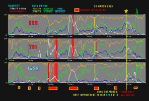

past wk
(2020-03-06, 16:16)cutty Wrote: past wk
Wow! How much of that was done in a graphics editing program? I'd like to see my stations automatically displayed on the same page like this!
Like This?
https://frankfortweather.us/frankfortblitz/
Thanks! That looks easy enough.
EDIT: Since I don't have a web server right now, I just have 1977 and 2294 in two different browser tabs, and just switch between the two.
