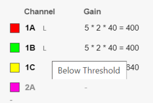

					Live signals A, LA.

		2024-09-02, 20:53
		L = Signal not sent. Signal is below the threshold you set for each channel. To be processed, a channel's threshold must be at least twice the channel noise level also. P = Signal not sent. Signal is below threshold * adjustable_percentage. A = Signal not sent. You enabled Automatic filter by amplitude function, and the algorithms trigger the filter. Best is to run full manual and not rely on the controller automatically adjusting the gain. Hope this helps.
		2024-09-03, 05:17
		When you hoover with the mouse over the character (L in the screenshot), the meaning will be shown in a tooltip. I'm personally happy to operate my stations in full auto mode controlled by the Blitzortung servers. For me this is a stress reduction because I do not longer have to adapt settings depending on wheather or environmental conditions. Stations web page: Settings -> Main -> Remote Control -> Automatic Mode
		Many Questions can be resolved using controller gui page.. "About" "Blitzortung.org Manual" e.g. your query: https://docs.lightningmaps.org/station-o...s/#filters The mouseover, tracker and GPS info MAY NOT always be displayed on controller, IF controller is using max memory for SIGNALS processing... mem is limited, and the 'page GUI displays' are the first to be sacrificed in order to send / recieve data. Re: 'automatic" mode... as Gerbold mentions, Many operators rely on full automatic... and it definitely is a plus in some situations. However, in general, for BEST data, etc, it's better to operate in manual mode, with optimized settings, so that the 'relative' status remains consistent for a station... 'effective gain', relative peaks, noise basement etc. When 'optimizing' a station for it's environment, location, etc, Automatic should NEVER be used, always use manual to establish the 'general' ambient environment averages over a period of time. There are other reasons 'automatic' MAY NOT be the best mode of operation for most stations, but as Gerbold suggests, for some locations may benefit from it's deployment. In my case, with my extremely variable noise environment, for example, automatic is quite detrimental, I prefer to allow the Interference Modes to operate as designed, most of the time, and rarely make an adjustment otherwise. In extreme situations, I have built up a 'composite' remote, which runs locally on my 'main' PC, where I can manually hit all my systems at once, according to long term 'general' situation adjustments. A crappy video of it to illustrate is here: https://frankfortweather.us/blitzblitz/B...emCon.html It's not always 'effective', IF the controllers are under heavy data processing and the moment, but then I shouldn't be 'diddling' with them that much, since it plays heck with the 'relative' station DNA pattern stored in the receiving servers processing computer. (The 'Sieve' database of last 1000 signals sent).
