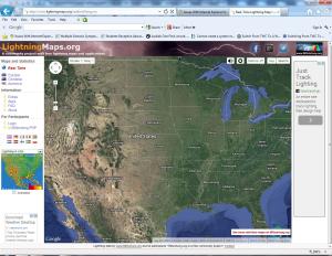

[attachment=1387]Hello. Nice to meet you all! This is my first posting on this forum.
I am having an issue with your website LightningMaps.org on my Windows 7's Internet Explorer web browser. Now, the last few days, when I open the webpage for LightningMaps.org [http://www.lightningmaps.org/realtime?lang=en], I do not see any active and current lighting strikes demonstrated when indeed there are lightning strikes outside my area. All I see in the larger interactive centered (main) Norton American continent map is NO lightning activity. However I can see on the LightningMaps.org window to the far left side of the larger centered (main) interactive North American map, a miniaturized static North American map with the actual lightning strikes represented (under "Lightning in USA"). I do not know why the larger centered (main) North American map no longer shows any active and recent lightning strikes? Something somehow has stopped active and recent lightning strikes from appearing on the main interactive North American continent map. I have not changed any settings or configurations here. I have attached a screen clipping of the “Lightning” window (LightningMaps.org) to demonstrate what I now see for your inspection.

Actually the version of IE I have is IE9, not IE7. IE7 was the IE baseline IE for Windows Vista. I did upgrade to IE11 and I see now the interactive main center screen of the North American continent does show lightning strikes now! Great! However, this does not make sense! I DID HAVE the lightning strikes showing at first with IE9 before it stopped?!?

There was a bug and the map now works again with older browsers that don't support Websocket technology. However, we always recommend to use a modern web browser.
