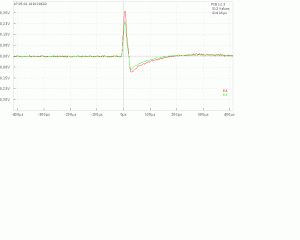

You sending a lot of disturbers :
Whats this ?  An electric fence ?
Thomas
Stations: 1006, 1305
