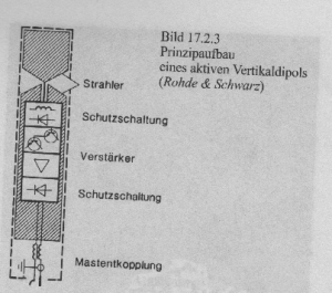

I wonder is it possible to shield the E-field
Because I see it receive many noise really many !!!!!!!!!!!!!!
I have test it
Test 60min
Test 1 only the shield ferrite 18:45 – 19:45 = signals = 3052 M=48.2% L=20.9%
Test 2 ferrite shield + 90cm loop = signals = 5670 M=20.7% L=33.5%
Test 3 E-field ( 20cm ) signals = 32854 M=11.1% L=9.1% very high !!!!!!
Here below the graphic
You see the green line this is ok but the rest is to noisy
So is it possible to shield the E-field ??

E field is designed to detect the electric component of the signal. Shielding is designed to eliminate the electric component, on magnetic (H field) loops. The E-field is a 'probe' antenna, and it's effectiveness depends upon "air", and the probe's physical dimensions ... it should be mounted outdoors, say a minimum of 2 meters above ground. Mine is 7 meters. And it should be mounted as far away from buildings, noise sources as is practical. Because of the construction, you're not limited in recommended Cable runs, as recommended for H field... so theoretically you could easily locate the assembly a hundred meters away from the Amp and Controller... the signal delay / power loss / noise isn't the same with Coax as it might be with CAT cable....
The other thing about E field... the system is very sensitive... for example, attempting to run with similar gains to settings for H field will result in 'too much' gain.. the pre-amp gain for RED E field is actually held low by design. During development, it was noted that 'even a metal beer bottle cap' for a probe will work!

It is also important to understand that in the e-field system the grounding is part of the antenna.
A noise free ground is just as much important as a noise free probe.

It doesn't matter where the ground is. Since the e-field antenna has no counterweight and isn't decoupled (wouldn't make sense without counterweight), the ground wire acts as radiator (also the coax shield if the ground is at the controller).
Could be prevented if it was this way:

 Since "it doesn't matter where the ground is", my strong suggestion, for RED, especially dual RED with H and E field reception, is to stick with the cookbook, and ground at the controller only.
