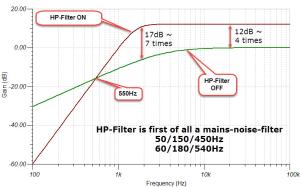

HP-Filter is first of all a mains filter
If you do not have that noise, cut it off, as it also have en extra gain you do not need
/Richo
