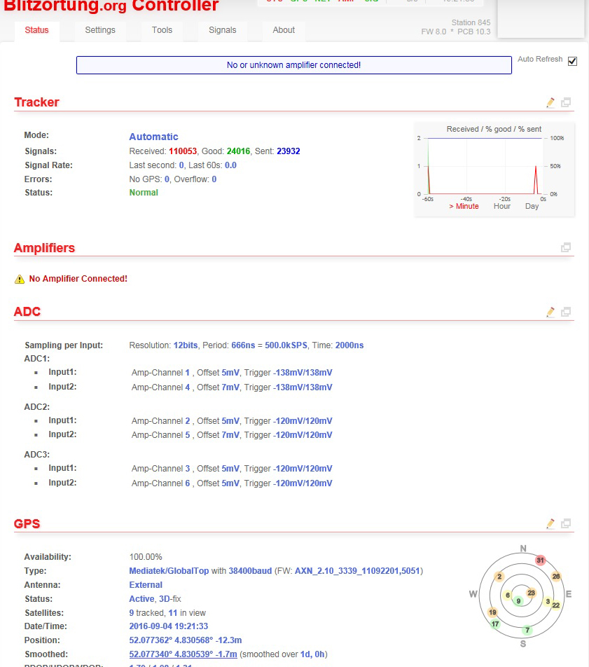

Hi for some weeks I have a problem with the red board
I see a error No Amplifier connected
I have test this with 2 antennas and also with 2 amp boards
All with 2 different ferrite antenna
1 on the roof and for this moment 1 into this room
The firmware version I have is now 8.0
But also with the 7.4 version I have the same problem
Ware can I look for fix this problem ?
Greetings Gert

Now I see into the screen from the board a new error
I see now into the SYS option Vin Too low !
don't know if this normal ?
