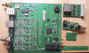

My PCB:
Is correct power supply?
Yes, It is correct
(2016-09-29, 14:34)Ranieri Wrote: My PCB:
Yes you have the latest version! Everything is fine!

My PCB is 20.2 not 20.3.
A brief explanation: PCB 20.2 is a panel that combines three PCBs:
-> PCB 19.3 (the main board)
-> PCB 16.1 (the H-field pre-amplifier), and
-> PCB 17.1 (the E-field probe).
The main board PCB 19.3 do not need an additional piggyback voltage regulator because it has three voltage regulators on board.
That is, you do not need an additional voltage regulator for PCB 19.3.
/Egon
