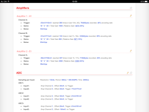

Thanks for the quick reply. I was interested to see if they should be the same gain or at least if most people have the same gain on each antenna, but as you say this isn't important, as long as it receives the signal from the lightning.
I have held a radio amateur license since 1980 and work in rf system design/production (although it is microwave now), so I am interested in the technical side.
To try to find out a little more, I moved my system blue from the attic to a summer house in the back garden. The gain for the two H field antennas stayed the same, but the gain for the E field antenna went up quite a bit, indicating that the E field noise is much lower in the back garden.
Although I am running much lower gain on my N/S ferrite rod, it still picks up lightning quite nicely from the south, so rather than the noise been more in this direction, I think it might be that my location has less attenuation N/S than E/W?
About 100m south of me there is a small electrical sub-station and then 400m south there are two sets of HV power lines, but with system blue in the back garden both of these will be below ground level as they are down in the valley. There is a TV and FM transmitter about 5km away, also to the south but I doubt it is that which is causing noise?

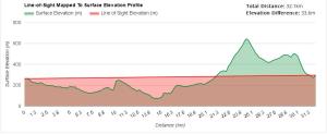

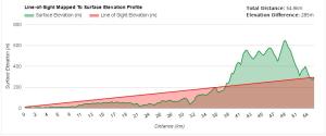

1) My minimum H field noise is on bearing 85/265 degrees, by rotating my ferrite rod antennas around.  If I measure on GE, Anthorn is 265 degrees from me at a range of 97km.  I have attached the line of sight profile.
2) Skelton is 245 degrees and 79km.  There is a lot more hill in the way from Skelton, see attachment.
3) Looking at my H field spectrum (Blitzotung recent signals) I can nearly always see a signal just below 20kHz, so it looks like Anthorn might be my main source of noise.
4) Looking at my E field spectrum there is a spike at 38kHz and again 76kHz (smaller), I suspect these are coming from a switch mode PSU, 38kHz fundamental and the first harmonic.
So if I arrange my N/S antenna to have the null at 265 degrees it is working quite well.  I just need to sort out my E/W antenna, not sure if it possible to make a loop with a null to one side and the main lobe to the other?
Alternatively, I will have to look at filtering, either the filter IC or possible a notch filter for 19.6kHz in the antenna connections?
Regarding E field noise, I will try to track down the rouge/noisy PSU and swap it out.  Or again fit the filter IC and cut above 20kHz.
Robin
Of course you are a lot closer and there is a lot less hill in the way.
Anthorn - Alston
Skelton - Alston

I like those terrain plots, I'm glad you posted Alston > Anthorn/Skelton as well or I'd been asking. Smile
