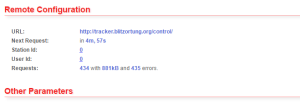

Remote configuration errors
Sad
I trust this should not be happening:
I have the System Blue registered...I think. Dodgy
Earlier today my station ID appeared here.  Now it doesn't
Ideas anyone?
--Kurt
Stations: 1809
(2017-04-22, 00:27)N0BGS Wrote: I trust this should not be happening:
Ideas anyone?
--Kurt
