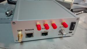

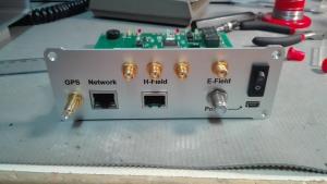

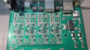

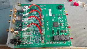

today I installed the four digital lowpass filters. The noise floor droped from 110mV to 50mV,  Which allowed me to raise the gain to 16X10 with no problem. I`m running in manual mode. I`m testing yet the best value for LPF tune, but seems to be around 50KHz. I have the LPF tuned in 25Khz and monitoring the spectrum but I can`t see advantage  in relation to 50Khz. I have a lot of militar stations in VLF with very strong signals (about 75 or more dBuV) between 15KHz and 60Khz which occupy part of spectrum, but apparently without causing problems.  I`m able to tune and measure this stations on my VLF receiver R&S EK070, with an R&S EH10 active antenna. I also took 4 outputs on the back panel to connect the oscilloscope.
I think the lowpass filters were a good investment, but I have to wait some more time to check the operation.

That is a very impressive build and construction!

Now, do one thing... examine that board very closely, after insertion in the metal case, for any possible
shaving from the 'screw drills' that might be present!
