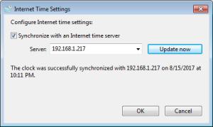

It uses the GPS time together with the local 1 PPS timing pulse.
enable the NTP server,
for example, in Windows, go to cliock settings,
set by internet,, and paste the controller LAN url into
the server select box, as in attached....
(remember the default lan is...235  not 217)
Now, the clock did set, when I tried connecting from WAN
but indicated that it 'didn't' because it timed out....
This is another 'add on' that can slow the controller down, by the way.
