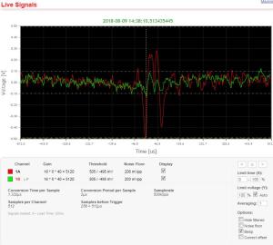

Stuff seem to work ish but i get a really low signal. amplification don't seem to change from either pot or from controller
looking at noise floor on different amplifications.
32x32
1x1

Actually.. i removed the ampboard. disconnected the tp cable. i still get the same noise baseline and som faint detection. heh. allright. time to start measuring stuff if it works att all.. gee..
Think i found the problem. mixed up ic6 and ic7. hope they survived.. to the unsoldering station.!
Ah that was the problem!
Now i have great signal! and amp levels do work.
so the "signal" i got earlier was only from the cat cable connecting to the amp.. :p

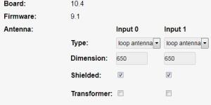

xztraz: A mistake in the diameter value of your loop antenna - 65mm is entered. It should be 650mm, I think.
(2018-08-10, 13:43)kriu Wrote: xztraz: A mistake in the diameter value of your loop antenna - 65mm is entered. It should be 650mm, I think.
Ah mm it is. Fixed
no unit specified on input page

also turns. i think there should be a more visible explanation than a tooltip,
Stations: 2265
(2018-08-12, 15:22)xztraz Wrote: also turns.  i think there should be a more visible explanation than a tooltip,
Yes! I never thought of mousing over the fields, either. And the tooltip doesn't show on my tablet.
Enter the diameter and the number of turns separated only by a comma (no spaces). For example, I'm using 4-turn wire loops that are 707mm in diameter*. Therefore, my H-field antenna entries are 707,4.
*They are diamond-shaped, the distance between opposite corners being 1000mm. If they were round, I would enter 1000,4 instead.
