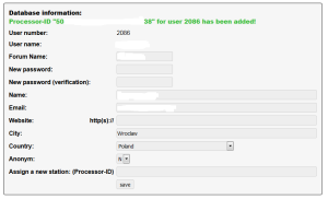

1. I'm not able to assign station to user. I've been trying to assign my new station to my account since yesterday but somehow it didn't work.

Is there a chance you give me a hint about my first problem?
I tried to tied my station(Processor-ID) to my account but still it didn't work.

Did you plug your controller Device-ID number, (Connect to your controller and scroll to Controller/CPU)
into the Processor-ID field of your BO profile? Just the numbers, no dashes (-).

Yes, I tried several times put Device-ID from Controller/CPU to "Assign a new Station (Processor-ID) in my profile. Every time I got notification that Processor-ID has been added. But i don't see any changes. Still my station is no assigned.

Update: I solved this issue by assigning my station to newly created user using link on BO controller page. (I'm aware that it was against the advise from BO, but this solution worked fine and my station is finally assigned).

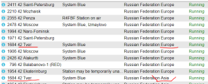

Why is the Asian listing displayed? How can you remove Asian? Leave only European?
Stations: 1684, 2917
(2020-08-18, 14:53)malyan Wrote: Station 1684
(2020-08-19, 15:09)cutty Wrote: This question keeps repeating...already answered at least once in this thread alone:
Quote:You are listed twice because your station is server configured to report data covering 2 regions.  Lightning maps will show stations depeding on which region you've logged into on LMO. If no signals are shown in a region, depending on variousd parameters and time frames, you may not show on a specific region listing.
 In this case supporting both Asian region, and Europe.  If you select "all regions" on Blitzortung Station list, you will see 'both' regions.
If removed from Europe, you will no longer help locate for that region. Normally, only selected stations due to quality and location directly support multiple regions.
