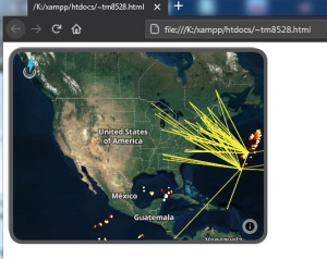

Code:
<!DOCTYPE html>
<html lang="en">
  <head>
    <meta name="viewport" content="width=device-width,initial-scale=1">
    <meta charset="utf-8">
    <meta name="dcterms.created" content="Sun, 06 Dec 2020 16:50:02 GMT">
    <meta name="description" content="">
    <meta name="keywords" content="">
    <title></title>
        <style>
  #hedd {z-index:20;position:relative;height:306px;margin-bottom:00px;
  border:.2vw solid #909090;
    border-radius:23px;
  margin-left:0;
        width:406px;
  #hedd iframe {
    display: block;       /* iframes are inline by default */
    background: transparent;
    border: none;         /* Reset default border */
    height: 300px;        /* Viewport-relative units */
    width: 400px;
  margin-left:0px;
    border:6px solid #555555;
    border-radius:20px;
</style>
    <!--[if IE]>
    <script src="http://html5shim.googlecode.com/svn/trunk/html5.js"></script>
    <![endif]-->
  </head>
  <body>
<div id="hedd">
          <iframe name="content_frame" src=
"https://map.blitzortung.org/index.php?interactive=0&amp;NavigationControl=0&amp;FullScreenControl=0&amp;Cookies=0&amp;InfoDiv=0&amp;MenuButtonDiv=0&amp;ScaleControl=0&amp;LinksCheckboxChecked=1&amp;LinksRangeValue=10&amp;MapStyle=0&amp;CirclesCheckboxChecked=0;MapStyleRangeValue=10&amp;Advertisment=0#1.72/37.1/-95.21"
          id="content_frame" ></iframe>
        </div>
  </body>
</html>
This example should work fine if you set your variables to suit.. Convert all "&" to "&amp;"
