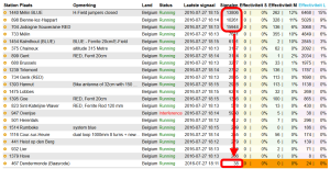

I got my system running (RED) and i notice that my detections are low compared to others.
Know it's running but do i need to improve ?
In attach i added a screenshot
Stations: 467
(2016-07-27, 18:38)NobelsKr Wrote: I got my system running (RED) and i notice that my detections are low compared to others.
We know nothing about the settings of your station. Maybe configuration is bad, antenna not connected, very bad location. The screenshot support your statement, but does not help.

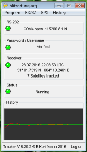

(2016-07-28, 21:55)Knolau Wrote: We know nothing about the settings of your station. Maybe configuration is bad, antenna not connected, very bad location. The screenshot support your statement, but does not help.
RS232 -> board speed is 115200 Baud
GPS -> EM-406A/SiRF
GPS Speed -> 19200 Baud
Firmware is 6.20.2
Do you need more settings ? just ask  Smile

(2016-07-28, 22:13)NobelsKr Wrote: Do you need more settings ? just ask  Smile
Gain settings? Read the manual and look at the amplifier board Wink
It looks like your station detects just on 1 channel (red), antenna is in West-East direction. Other ferrite rod connection seems to be wrong. Just a vague speculation.  Cool
