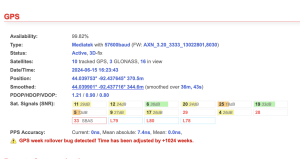

I currently have a Mediatek GPS antenna with a male connector. See attachment.

for my new system blue mini I purchased this one from amazon:
https://www.amazon.co.uk/gp/product/B09TLFG368/
seems to give good results so far.  GPS receiver is location in the loft just under a roof tile and I still get good reception.
[Image: Capture.JPG]
Regards Simon
https://www.conligwx.org
Stations: 1283, 3079
(2024-10-14, 13:54)Toxic Wrote: Hi
