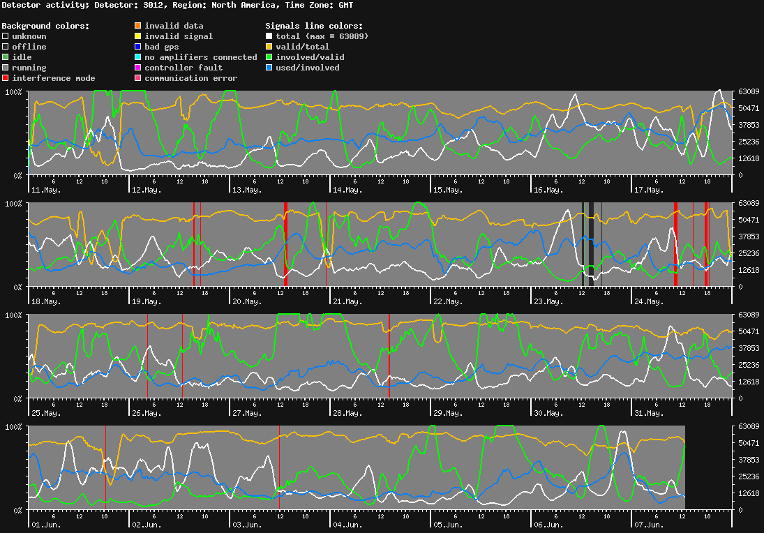

Also reflected in the stations performance graphs, as in:
https://map.blitzortung.org/statistic_1....nsparent=0
during the last 2 (?) hours,
Total=signals sent by station
Valid=how many passed server checks initially... best channel data that fits... other channels rejected.
Involved=This station's valids which are determined to be an actual impulse, (detected) when matched with all data from other stations ("detected strokes")
Used=how many of this station's 'Involved' were used to actually compute stroke locations (out of
all signals from all stations,
ONLY the best (up to
17 maximum) signals used to locate
