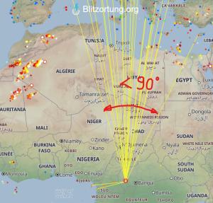

Here is another representation (I should have started here) to illustrate that in many case in southern and remote area. the limiting factor is the angle even more than the distance from the detectors.
This strike was seen by more than 40 detectors in Europe, but it will not be computed without contribution from the south.
South America have a similar situation with hundreds of detectors in North America but not many that can provide the angle coverage.
The southern part of both continent are very unlucky and out of reach
New detector in Northern Brazil will help. Eastern Brazil would be great !
Hope it clarify my point.
