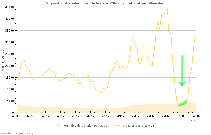

Test 1  only the shield ferrite 18:45 – 19:45   =    signals = 3052   M=48.2%  L=20.9%
Test 2  ferrite shield  + 90cm loop =  signals = 5670   M=20.7%  L=33.5%
Test 3 E-field ( 20cm ) signals = 32854   M=11.1%  L=9.1%   very high !!!!!!
Here below the graphic
You see the green line  this is ok   but the rest is to noisy
So is it possible to shield the E-field  ??

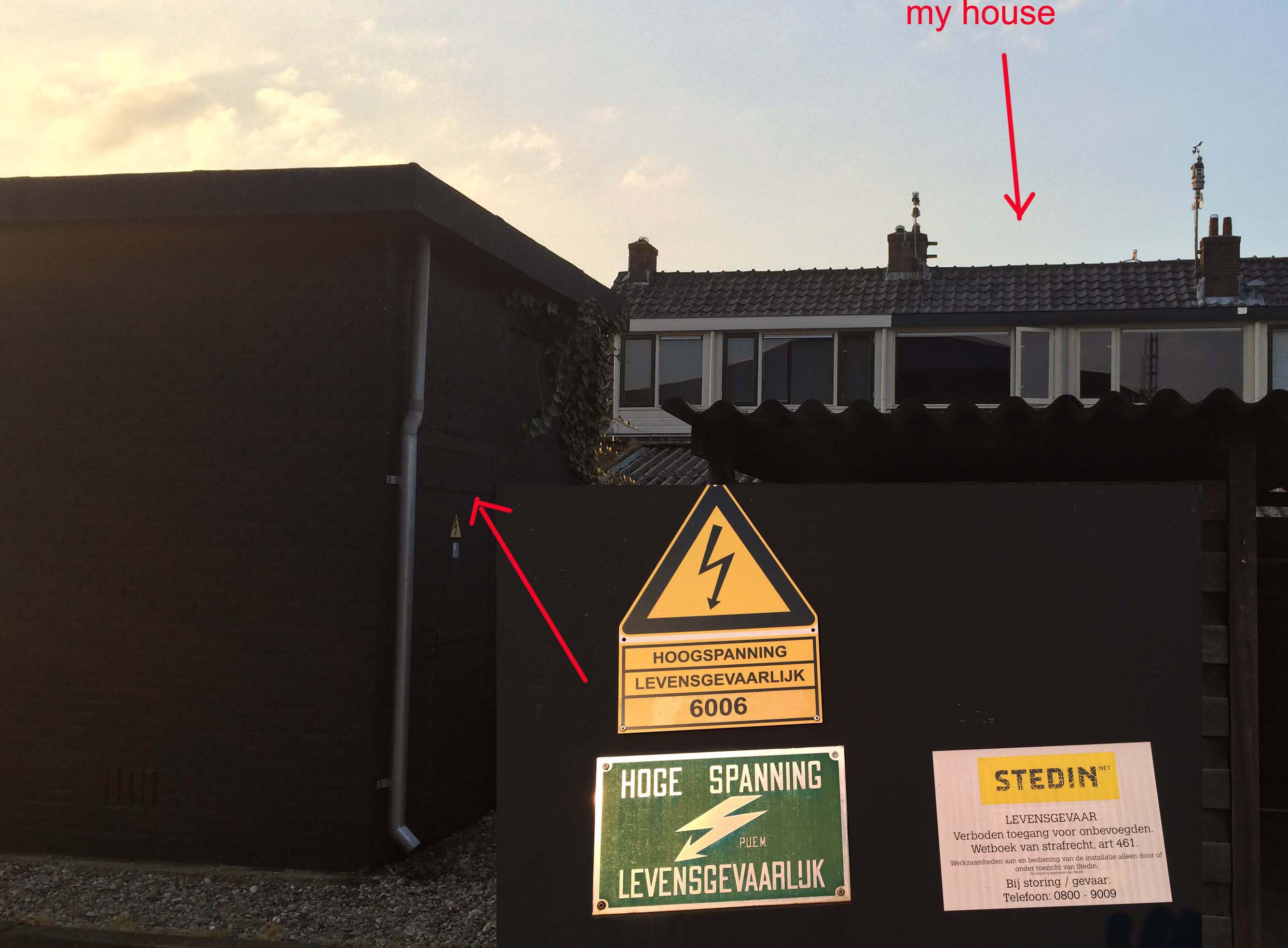

               from this big  380V noise  maker  Thomas
[Image: powerhouse1.jpg]

Ahhhh,
I remember this picture Wink

Only I find something strange   with low lighting  I have also low noise
And if there is high activity   my noise go also very fast up
