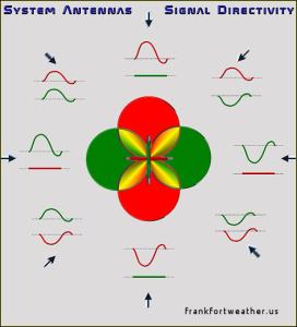

Hello, my name is Oana Liviu from Romania and I am currently operating the station number: 951 from Resita, Romania (system RED).
It is well known that if you use two perpendicular antennas, if you position them to N-S/W-E and you wire them correctly, you can get an estimate of the direction of the strike by processing the raw signal data (see attached image). This can be acheived by calculating the arctangent of the ratio between the signals coming from each antenna among some other calculations.
Let's say that one is able to determine a relatively correct direction of the signal.
My question is: if the calculated direction by the means posted above is somewhat the opposite of the real direction (the strike is located to the south-west, but the calculation yields a north-east direction), that means that that strike have a positive polarity? Considering the calculations have been correctly done?
I am considering some experiments based on this and I want to know if I'm heading in the right "direction".
Thanks Wink

So basically by processing the direction component of the signals, one can tell if the lightning originates from the ground, but only an E-field antenna could detect the positively-charged lightnings that occures between an anvil and the ground?
Best regards,
Liviu.

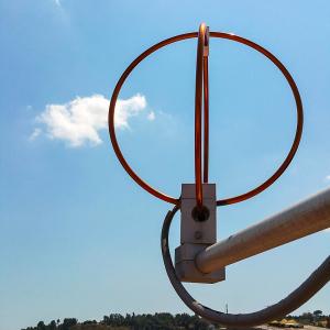

For example, LINET system uses loop antennas and can detect all types (and other data) of discharges: CG, IC, polarity and lightning current values.
Below antenna for LINET system.
Kriu,
you are right: they use only the loop antennas. The webpage of the company is: https://www.nowcast.de/.
The high accuracy of their detection (they claim 100 m to 75 m) allows them also to check for the height of the discharge, but I am not sure what their efficiency for intra- or inter cloud lightning really is - what do they use as reference??
Anyway, this appears to be the best current system for lightning detection.

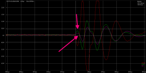

I have received a signal from a lightning which saturated one of the H channels. Data from the european lightning detection network EUKLID could be correlated with this ligthning, it was a very strong negative lightning with -144 kA strength. The E field channel (magenta trace) goes POSITIVE in the first peak of the signal, so this is the signature for negative CG lightning. Positive CG lightning will first go negative in the E field channel.
Stations: 1836
(2017-08-28, 09:45)pasense Wrote: I have received a signal from a lightning which saturated one of the H channels. Data from the european lightning detection network EUKLID could be correlated with this ligthning, it was a very strong negative lightning with -144 kA strength. The E field channel (magenta trace) goes POSITIVE in the first peak of the signal, so this is the signature for negative CG lightning. Positive CG lightning will first go negative in the E field channel.
That would be an interesting observation... if it proves consistent. Using the attached correlation E with Channel C ...(E signal in phase with A and B, trust me,)  which of the following random "sferics" might be "Positive" sferics? Rolleyes Why?  (Just assume they're all strokes, not junk)...

I used the very beginning of the signal, so this cannot be a reflection which is contributing only later to the signal. The line of sight from the station to the stroke was only over the sea, so the ground wave had little attenuation. I will try to get the opinion of lightning location specialists on this topic (identification of polarity for distant strokes).
Cutty, there was another stroke only 40 msec later at the same postition, so this is consistent with a negative stroke. Positive CG has only very rarely a second stroke at exactly the same position. A problem with +CG is that these waveforms are more complicated than -CG because very often there is significant cloud discharges before the return stroke. Sometimes this even leads to strong +CG not being identified correctly, instead a cloud discharge is assumed by the system.
What do the colors in your attachments stand for?

Assuming  the magenta channel is the E field and the yellow one the H field, this is my tentative identification:
Positive query huh
unclear -CG
unclear -CG
+CG     -CG
-CG ??  -CG
unclear +CG
-CG      -CG
positive query huh2
+CG    +CG
unclear -CG
+CG    +CG
-CG     +CG
unclear unclear
unclear +CG
I used the polarity of the first part of the E field signal, when I could identify the start. When the first pulse of the E field is positive I identify it as -CG, when it goes negative as +CG. This is then in line with the signal I presented above.
I would have prefered to see the horizontal H signals as well to get a better idea of the start, the signal of the  C channel is a bit weak.

Correct on Yellow being H C, and Magenta is E... this should be the standard...
I threw a curve, "Huh2" is simply 'Huh" inverted and mirrored.,... same signals... just diddled. Done to illustrate the possible difficulty of the premise....and if we only 'compare' one H channel,  than the 'missing' A and B channels are irrelevant for this illustration of channel vs channel... My experience with both RED and BLUE indicates that E is almost always In phase with one or more channels...
Sol, if we're looking for the 'out of phase' H vs E.... which H channel should we use as H ref?
