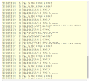

The debug log is repeating the following sequence over and over again.
2017-09-05 11:17:45    109 | GPS: 1PPS deviation too high 307330. Reset counter!
2017-09-05 11:17:45    109 | AMP2: Set gain 6 on channel 0, op-amp 0
2017-09-05 11:17:45    109 | AMP2: Set gain 5 on channel 0, op-amp 1
2017-09-05 11:17:46    110 | GPS: 1PPS deviation too high 267908. Reset counter!
2017-09-05 11:17:46    110 | GPS: Bad accuracy, resetting smoothing.
2017-09-05 11:17:47    111 | GPS: 1PPS deviation too high 249264. Reset counter!
2017-09-05 11:17:47    111 | GPS: 1PPS inaccurate! Counter is 44268950, should be around 84000000
2017-09-05 11:17:49    113 | EVENT: GPS 1PPS counter is accurate again.
2017-09-05 11:17:49    113 | GPS: 1PPS OK
2017-09-05 11:17:50    114 | GPS: 1PPS deviation too high 40448537. Reset counter!
2017-09-05 11:17:50    114 | GPS: 1PPS inaccurate! Counter is 43500712, should be around 84000000
2017-09-05 11:17:50    114 | REMOTE-CONFIG: Server '2' deactivated
2017-09-05 11:17:50    114 | REMOTE-CONFIG: Server '2', expert '0'
2017-09-05 11:17:50    114 | REMOTE-CONFIG: Server '2' activated
2017-09-05 11:17:50    114 | REMOTE-CONFIG: Server '2', expert '1'
2017-09-05 11:17:50    114 | REMOTE-CONFIG: Done with 5 updates and 0 errors
2017-09-05 11:17:52    116 | GPS: 1PPS OK
2017-09-05 11:17:55    119 | AMP2: Set gain 5 on channel 0, op-amp 0
2017-09-05 11:17:55    119 | AMP2: Set gain 3 on channel 0, op-amp 1
2017-09-05 11:18:00    122 | RTC: Setting RTC from GPS time, time difference was -2s
2017-09-05 11:18:06    128 | ADC: Watchdog is pending since 2s (0x25 0x24 0x24) -> RESET -> (0x24 0x24 0x24)
2017-09-05 11:18:06    128 | REMOTE-CONFIG: Server '2' deactivated
2017-09-05 11:18:06    128 | REMOTE-CONFIG: Server '2', expert '0'
2017-09-05 11:18:06    128 | REMOTE-CONFIG: Server '2' activated
2017-09-05 11:18:06    128 | REMOTE-CONFIG: Server '2', expert '1'
2017-09-05 11:18:06    128 | REMOTE-CONFIG: Done with 5 updates and 0 errors
2017-09-05 11:18:07    129 | ADC: Watchdog is pending since 3s (0x29 0x28 0x28) -> RESET -> (0x28 0x28 0x28)
2017-09-05 11:18:07    129 | AMP2: Set gain 5 on channel 0, op-amp 1
2017-09-05 11:18:08    130 | ADC: Watchdog is pending since 4s (0x25 0x24 0x24) -> RESET -> (0x24 0x24 0x24)
2017-09-05 11:18:12    134 | REMOTE-CONFIG: Server '2' deactivated
2017-09-05 11:18:12    134 | REMOTE-CONFIG: Server '2', expert '0'
2017-09-05 11:18:12    134 | REMOTE-CONFIG: Server '2' activated
2017-09-05 11:18:12    134 | REMOTE-CONFIG: Server '2', expert '1'
2017-09-05 11:18:12    134 | REMOTE-CONFIG: Done with 5 updates and 0 errors
2017-09-05 11:18:18    140 | AMP2: Set gain 6 on channel 0, op-amp 0
2017-09-05 11:18:18    140 | AMP2: Set gain 2 on channel 0, op-amp 1
2017-09-05 11:18:28    150 | AMP2: Set gain 5 on channel 0, op-amp 1
2017-09-05 11:18:39    161 | REMOTE-CONFIG: Server '2' deactivated
2017-09-05 11:18:39    161 | REMOTE-CONFIG: Server '2', expert '0'
2017-09-05 11:18:39    161 | REMOTE-CONFIG: Server '2' activated
2017-09-05 11:18:39    161 | REMOTE-CONFIG: Server '2', expert '1'
2017-09-05 11:18:39    161 | REMOTE-CONFIG: Done with 5 updates and 0 errors
2017-09-05 11:18:40    162 | AMP2: Set gain 5 on channel 0, op-amp 0
2017-09-05 11:18:40    162 | AMP2: Set gain 4 on channel 0, op-amp 1
2017-09-05 11:18:45    167 | REMOTE-CONFIG: Server '2' deactivated
2017-09-05 11:18:45    167 | REMOTE-CONFIG: Server '2', expert '0'
2017-09-05 11:18:45    167 | REMOTE-CONFIG: Server '2' activated
2017-09-05 11:18:45    167 | REMOTE-CONFIG: Server '2', expert '1'
2017-09-05 11:18:45    167 | REMOTE-CONFIG: Done with 5 updates and 0 errors
2017-09-05 11:18:50    172 | GPS: Receive OK
2017-09-05 11:18:50    172 | EVENT: GPS data check ok.
2017-09-05 11:18:50    172 | GPS: Everything OK
2017-09-05 11:18:51    173 | REMOTE-CONFIG: Server '2' deactivated
2017-09-05 11:18:51    173 | REMOTE-CONFIG: Server '2', expert '0'
2017-09-05 11:18:51    173 | REMOTE-CONFIG: Server '2' activated
2017-09-05 11:18:51    173 | REMOTE-CONFIG: Server '2', expert '1'
2017-09-05 11:18:51    173 | REMOTE-CONFIG: Done with 5 updates and 0 errors
2017-09-05 11:18:51    173 | AMP2: Set gain 3 on channel 0, op-amp 1
2017-09-05 11:18:57    179 | REMOTE-CONFIG: Server '2' deactivated
2017-09-05 11:18:57    179 | REMOTE-CONFIG: Server '2', expert '0'
2017-09-05 11:18:57    179 | REMOTE-CONFIG: Server '2' activated
2017-09-05 11:18:57    179 | REMOTE-CONFIG: Server '2', expert '1'
2017-09-05 11:18:57    179 | REMOTE-CONFIG: Done with 5 updates and 0 errors
2017-09-05 11:19:04    185 | REMOTE-CONFIG: Server '2' deactivated
2017-09-05 11:19:04    185 | REMOTE-CONFIG: Server '2', expert '0'
2017-09-05 11:19:04    185 | REMOTE-CONFIG: Server '2' activated
2017-09-05 11:19:04    185 | REMOTE-CONFIG: Server '2', expert '1'
2017-09-05 11:19:04    185 | REMOTE-CONFIG: Done with 5 updates and 0 errors
2017-09-05 11:19:06    187 | AMP2: Set gain 6 on channel 0, op-amp 0
2017-09-05 11:19:06    187 | AMP2: Set gain 5 on channel 0, op-amp 1
2017-09-05 11:19:14    195 | REMOTE-CONFIG: Server '2' deactivated
2017-09-05 11:19:14    195 | REMOTE-CONFIG: Server '2', expert '0'
2017-09-05 11:19:14    195 | REMOTE-CONFIG: Server '2' activated
2017-09-05 11:19:14    195 | REMOTE-CONFIG: Server '2', expert '1'
2017-09-05 11:19:14    195 | REMOTE-CONFIG: Done with 5 updates and 0 errors
2017-09-05 11:19:16    197 | AMP2: Set gain 5 on channel 0, op-amp 0
2017-09-05 11:19:16    197 | AMP2: Set gain 3 on channel 0, op-amp 1
2017-09-05 11:19:26    207 | AMP2: Set gain 6 on channel 0, op-amp 0
2017-09-05 11:19:26    207 | AMP2: Set gain 5 on channel 0, op-amp 1
2017-09-05 11:19:34    215 | ADC: Watchdog is pending since 2s (0x25 0x24 0x24) -> RESET -> (0x24 0x24 0x24)
2017-09-05 11:19:34    215 | REMOTE-CONFIG: Server '2' deactivated

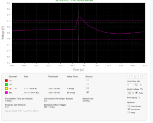

The signals, see:-
https://www.dropbox.com/s/ptqxgiuhulrxpm...8.png?dl=0
Again this seems to keep repeating this strange waveform and the numbers are just leaping about randomly.

(2017-09-07, 02:58)readbueno Wrote: I was only running for a short while, but, as you can see, very little has changed.
It does seem that the E channel is not going negative and the other two are just generating garbage interference.
Hi Brian,
The repetitive pattern on those 3 graphs almost looks like a bad switching power supply. Could the PS have damaged the controller, or vice versa? It's probably not, but I thought that I should mention it.
I power mine with the  5VDC 2A charger that came with my Android tablet.
73, Mike
www.w0btu.com
#20
Hi Mike, I was using a "high power" switched mode PSU, that now also refuses to produce its stated voltage and current.
What damaged what, is the Sixty-four million dollar question.
I have ordered the parts to make a dedicated Linear PSU that will have over voltage and over current protection built in and remote sensing, so the voltage that appears at the boards will be as correct as it should be.
This board is going back to Egon, for its post mortem, and I have bought a new board that I will be very careful with.
Regardless of my particular problem. I do feel that these boards should, for this price, be made as idiot-proof as possible?
Kindest regards,
Brian.
