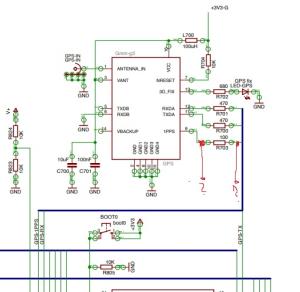

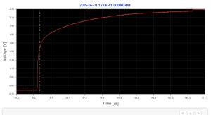

Weather muurame, your signal does not look right. It has a slow rise time and does not go all the way down to 0V. Ideally it should have a real sharp rise time. Check the voltage supplying the GPS chip. +3V3-G. It is generated by a dictated supply, IC505.

As you see main fault is in pps signal, it rises too slowly. Next I have to chcek IC505 as dupreezed proposed.

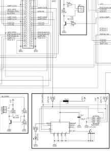

I would also check the signal from 9 pins of the chip with no R703 resistor and the voltage at the points of the soldered resistor

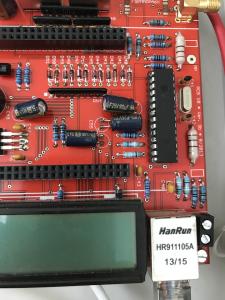

Can you advice me, where it is located on circuit board?

Controller board is 10.3

Oh sorry it's my fault (i'm mean for system blue)
trace signal pps without main board
Lightning Volodymyr Lightning
