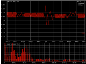

I have now finished building the kit and in the testing phase. Things seem to be working but I see no output from my site on the maps. Also I tried switching to manual mode for gain etc (set at 10,10 hp on & off) as suggested in the forum but the signal graph is then empty of a trace.
I am getting the odd flash on the signal led - more so when looking at the graph in automatic mode.

1. you have a lot of noise.... maybe still too close to computers, etc.
2. you DO have GPS connected?  It won't send without it...
3. 20mm H field ferrites are pretty small. recheck your station configuration page on main BT site...
4. get the antennas away from any interference sources...

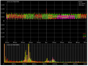

Hi Alan, Welcome, Here is the latest Picture from the net.
Big Grin Yes 20 mm doesn't look right 20 cm perhaps?
In manual I started at about 8 and 5 for the gains and 125 mV for the trigger threshold it seemed to be a good place to start.  Smile
Brian.

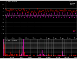

Hi Alan, Can you set all the channels to "do not send" and try one channel at a time. Your latest signal is still has a lot of interference and you have a lot happening at 40 and 80 KHz that seems to be swamping everything. There does appear to be some real signal in there as well, but it is pretty hard to work out what is going on in all of the clutter.

Hi
I just have channel A set to normal B&C to don not send. Still getting the freeze when using controller (with Google Chrome).

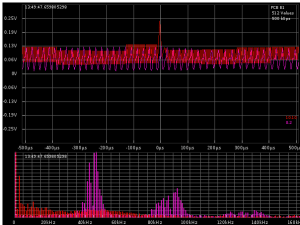

OK Alan That is a bit Clearer.
I am going to hazard a guess and say switched mode psu. However there are two different sources of interference.
Maybe there will be someone about who is better able to help identify those.
If you have a different PSU handy, that might be the first place to start, to see if you can get a clean bare board with everything running and no interference.
As you seem to have a problem with the GPS, it may be as well to disconnect the amps for the moment and see if you can get that set up, then when that is working, proceed with the amps one at a time.
In my experience, trying to solve more than one problem at once is not normally very successful.
Brian.

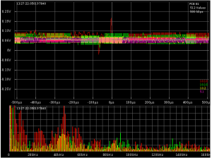

Alanpenwith,
the signals from your station only show a strong noise. Try to check the input voltage like this:
Blitzortung.org browser interface of your receiver -> Signals -> Signal tools -> select V_in -> start
and check what you get. If the graph looks like what you got as "signals", the power supply is the problem.

Hi
Yes I am getting interference all the time but the problem now is that as soon as I try to view the controller the gps led goes out and the station freezes. It has got worst since I upgraded to firmware 8.3 but I can't get into the controller long enough to try going back to 8.2.Until I go into the controller the the system appears to be working properly and sending data to the server.
