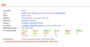

What is the top performing GPS Antenna/Unit currently available to interface with the Blitzortung servers?
I currently have a Mediatek GPS antenna with a male connector. See attachment.
I am willing to "upgrade" if it will be worthwhile.
Also what are optimal settings: for satellite types (GPS, GLONASS, etc) & baud rate others have used?
