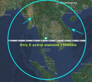

The ANSWER is quite simple, actually:
...and about a dozen DOA...

Yes you are right. I looked at https://map.blitzortung.org/#5/9.21/104.38 to see where there are active Blitzortung stations. All of the stations that immediately surround the Gulf are presently "offline". The way you can tell this is to look at the curved brackets that surround the colored dot of the station. The eleven or so stations that immediately surround the Gulf all have curved brackets that are gray.
- There have been five stations in Thailand and all are presently offline.
- There have been two stations in Cambodia and all are presently offline.
- There has been one station in southern Vietnam and it is presently offline.
- There has been one station in southern Myanmar and it is presently offline.
- There have been three stations in nearby parts of Malaysia and all are presently offline.
It would of course be most welcome if some of those stations could be returned to online status. This could help with the hole in detection that you describe.
Every now and then, a lightning strike in the Gulf of Thailand will get detected using signals from other Blitzortung stations that are much further away. For example just a few hours ago this strike was detected: 2025-09-16 20:39:17.239059456 .
With the help of forum member Robo I was able to learn more about how the Blitzortung system detected and localized that particular strike. One Blitzortung station that helped to find that strike was the sole active station in Vietnam (2243). Another that helped was in the Philippines (2710). Eighteen stations in Japan helped to locate the strike. And a station in Omsk, Russia (2769) helped -- that station was about 1700 km away from the strike.
This strike that I happened to notice on the map was, I suspect, a rarity for the location. I bet there are lots of strikes in the Gulf of Thailand that don't get detected.

(2025-09-17, 13:57)cutty Wrote: The ANSWER is quite simple, actually:
I bet some of the station operators whose stations are offline haven't even noticed this yet. We should ask Egon to finally implement an email notification when a station is offline for more than an hour.

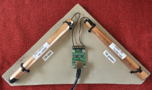

I looked at the station reports for those four stations. The green line is very low in the graphs, but the other lines look very encouraging. I think you have accomplished quite a lot. Thank you.
I see that for each of these four stations, you chose ferrite-rod antennas. I think that is smart. For the host with what might be limited experience, any other kind of H antenna has more ways it might go wrong.
Do you add shielding to the FRAs?
Do you mount the FRAs and preamp to a board, so reduce the risk the host will damage the fine wires from the FRAs?
