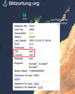

Where do I configure the city and country settings on my receiver?
Thank you very much!
https://www.blitzortung.org/login.php
You can update your personal info here.  NOTE: "Anonyn" means exactly that. IF you 'Y' you will NOT be visible to public, maps, etc.  Suggest leave it 'N'.
Scroll down
Your station info is below that 'profile' info, You should enter your antenna configurations while there.
You also enter the city, country, etc for that specific station,...again, "Anonyn" 'Y' means that station WON'T be visible. Suggest leave it 'N'. then scroll down past the 'last signal' images, and click "save"
