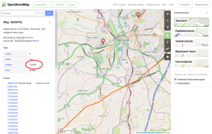

Openstreetmap says 132kV. As Richo said, corona effects can be problematic, but they almost not present at this low voltage.
