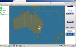

Also, my position on the Oceania area map is correct (harder to be precise due to scale) but the New South Wales map has an error.

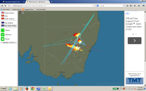

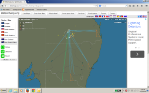

I have marked the position error with orange triangles. I know the location of Sth Sydney 1, Brisbane Nth & Albury -one of RossW's stations.
Thanks Ross for the link to your GPS data. For reference, South Sydney ! should be about 10km from the 'Sydney' city marker on the map.
These stations all appear to be out by the same error. Very roughly, the error is -1.25 degrees latitude +0.5 degress longitude.

The position error is apparent if NSW maps & Oceania maps are compared.
My station is a bout 3km from the cost, but it is a fair way inland on the NSW map.

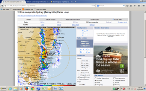

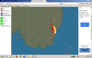

Hi argus42,
I agree - Ive attached 2 images of a storm passing through Sydney (Blitzortung & local weather radar). The NSW map is correctly reporting the storm locations, but the stations detecting the strikes are all showing the position error.
