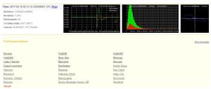

I am a new user for 3 days now.  I notice that a few of my reporting waveforms and spectrum plots are what I would call "very smooth" compared to most reports from my station and all other stations that I have viewed.  The system seems to be receiving and using these observations, as well as my more "normal" waveforms for calculations.  Can anyone explain these beautiful, but odd waveforms?  They only seem to show up at a range of 3,000 km to maybe 3,300 km ... very strange.
I have attached a screen shot of a report.  -Or- they show up often enough that you should be able to view them:  Station 1838 in Volcan, Panama.  Thanks for any information that you can give me.

So I'm going to start with "I don't have all the answers"....
It appears that the really smooth waveforms are something relatively local to you, and are not due to lightning. The system appears to "think" that some of the pulses are related to lightning strikes, but it's really just coincidence. Look at the time offset on some of your detected strokes. It's many 1000's of microseconds. The pulse fits a stroke that occurred somewhere, but isn't related. Alot of this really is guessing that a timed pulse that's within a window is related. Look at some other stations and yours with some closer strokes. The time offset is much lower. The matches probably occur during heavy lightning periods like tonight in the US. That way, one of the observed pulses has a bigger chance of fitting a window.

They are a strange signal but the spectrum plot reflects the impulse so I'd say they are real. As a check do they stop if you short the head amp loop inputs? How is the H-field head amp connected to the loops?
The other thing to note is that they are *BIG* signals, I've seen the peaks clipped off at something over 2.4 V peak to peak. The Y scale on many plots automatically scales itself to the size of the impulse, so what appears to be a similar sized signal can actually be very different. The fourth Y marker away zero on your plots varies from 0.08 V to 1.2 V. These "smooth" signals vary in amplitude from only occasionally 0.6 V P to P to overloading the amplifier at > 2.4 V P to P. Most "normal" signals are less than half that minimum, 0.16 to 0.3 V P to P.
As BobW says watch the "noise floor" display on the receivers Signals page and see if there is any sort of pattern or regular repetition. If they aren't very frequent getting a bearing from a loops null might be rather time consuming. On my 30 cm 20 turn loops the null is very deep but also very narrow. A tiny rotation, just a degree may be two, can take you from one side of the null to the other and with the amplitude varying anyway...
They look like switching impulses but can't think of anything that switches a fair amount of power (due to the signals size, unless it's very close) at what appears to be tens of seconds or a minute or two intervals.

(2017-05-19, 23:38)hp3ak2 Wrote: I am a new user for 3 days now.  I notice that a few of my reporting waveforms and spectrum plots are what I would call "very smooth" compared to most reports from my station and all other stations that I have viewed....
This signal certainly does not come from lightning. This is a disturbance from a nearby electrical appliance. Do these types of signals appear in series a dozen or several dozen signals per seconds?
Besides, your stations capture extremely a lot of bad signals and only a small percentage of them really are from lightning.
I suggest to significantly reduce the gain - 2-3 times. The amount of sending signals to the server should not exceed 20,000 per hour during a strong storm and 3,000 per hour during a period of low storm activity. You will see that the amount of correct detected signals from the lightning does not decrease significantly.

Thanks to all who have made suggestions and offered advice.  ** I believe that I have determined the following at this point with my system Red:
  1. The signals occur at approximately one second intervals, with some gaps.  This is identical in behavior to the electric cattle fences nearby in my shortwave receivers.
  2.  They are very strong compared to other signals being received, 1.2v / .23v (Equivalent of kilometer long transmitting antennas, 1/2 km distant.)
  3.  Slowly rotating my 1m crossed loops will null the signal in one channel, while maximizing it in the other channel.  I can make either channel very strong while making the other quite weak, or I can make both about equal, but very strong.  It does not appear that moving the antennas, within this neighborhood, will do any good at all.
  4. The blitzortung computers usually ignore these when sent; however, some of them are close enough in time stamp to be processed.
  5.  I have tried turning on the filters and setting the sensitivity back in each channel.  However, the signals are just too strong.
  6.  Since most of the energy is from 5 to 40 kHz, I don't believe that there is a practical way in which to filter it out.  Suggestions?
