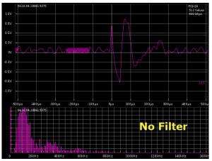

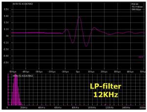

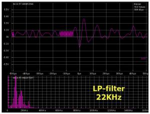

The filters are set for cutoff frequency in settings. these settings are NOT visible unless the devices are installed, you have the latest firmware, and the microprocessor is enabled with that jumper you mentioned. The 'idea' is to work between 3K-300KHz, but the actual high end is 328 in settings. On the "Low end", you can virtually turn a channel off... so say "0 to 328K" effective.
There's no need for these filters if you don't have the higher frequency noise. And eliminating noise with them between 3K and 30K actually kills a lot of the sferic information we're looking for. And they do work...extremely well.  However, I run mine wide open...why not? Same as not having 'em in there... ... my noise is all in that 'critical area' 3-30kHz, unfortunately... and it's sporadic.

First of all, "our" frequencies of interest are filled with noise, 3-30 (100) KHz, and most of it comes from lightning discharges.
There is ALWAYS natural noise, and most in areas with lots of lightning.
If we want high accuracy, we need signals with short rise time (high frequency) - It is achieved only close to the flash discharge (10-20 to 100-200km)
When we get closer, we are disturbed by the "precharges", and are we farther away, the higher frequencies are attenuated, and finally there are only signals around 10-12KHz
Dedicated receivers for long distance have a narrow range around 11KHz
Most spikes you see in an FFT analysis mean so little that there is no reason to dampen them further
I can not see you need extra filters
Finally I show pictures of what different filters do.
12KHz is very hard, but here it works well on middle and long distance.
/Richo
