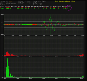

Hi Cutty,
The issue seemed to be because I hadn't plugged the H-field in (it's on my work desk at the moment) so the server wasn't recieving any signals.
I've plugged it in now so could you try again?
Thanks.

(7 hours ago)Bodger Wrote: Hi Cutty,
Thanks.
duh... I almost asked you something similar...
but I thought, nah ... surely not...
Upgraded your forum status... Note that the adjunct website from Tobi, lightningmaps.org, likely will NOT register your station until all the regional database experimentation on Computing servers settles down, and Tobi has time to rewrite... indefinite.
You're looking good, attached appears to be a fine, textbook 'sombrero' signal from current activity down in ?Spain? perhaps.
You now should go to your owner's page, and input your antenna family configuration for your station...
Sent you a brief PM...
