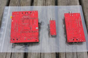

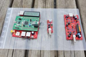

Assembled my E-field kit.
Just done soldering... that's a lot of joints Wink
@Egon Wanke The package arrived here yesterday and all looks fine Wink
Now it's time for some PVC tubing Big Grin
Bdw are those boards acetone proof? for cleaning the solder side?

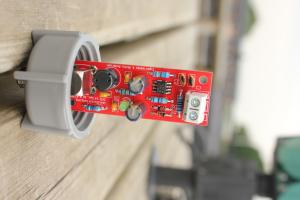

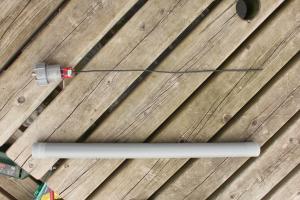

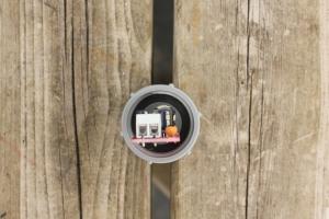

More pictures Smile Building the E antenna Smile
Using 32mm sewer pipe,just fits the preamp inside but be aware! The connector is offset! Not central!
Try it on a small area first, however Acetone would not be my first choice, it is rather too agressive, you will probably melt the LED's and take the markings off the resistors and capacitors along with the silk screen markings on the board if you are not careful.
Get some proper PCB cleaner, or failing that some isopropyl alcohol (your local chemist can probably supply it) or even methylated spirits.
