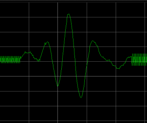

What is the cause of the "W" shape in my lightning signal? Is it real or is there a resonance in my antenna? Sometimes there are more cycles but the spacing is consistent, around 10 kHz. I don't see this curve in any articles about lightning physics, though some show oscillations but very rough.
I have seen this curve in other nearby station's data but I do not know their antenna setup. I have 4 turns on a 1-meter X-frame, no transformer, directly connected to the external H-amplifier. Turn spacing is about 2 mm.
Because of bad noise I have the low-pass filter installed, but I have seen the same curves without the filter during lucky stretches when the noise stops.
All the strikes are 2500 km or more from me, so maybe the curve is explained by different frequencies taking different paths. I will have to wait until summer to see the shape of closer strikes.
I will try to attach an image from lightningmaps.org

I is (should bee?) well known, than long distance lightning signals are following the ionosphere waveguide, and the dominent frequency in this waveguide is 10-11kHz.
What you see is exactly this phenomenon :-)
For the same reason, the receivers made for just very long distance lightning, are often tuned to that frequency.
Tuning provides shifts in the signal path (delay), and gives inaccuracy in the position fixing.
This delay we do not want - and that's why our receivers are a little more complicated than you would otherwise see.
What wave guide does is a physical phenomenon which we can not do anything about.
Well - because of this phenomenon, we can "see" far but not place determine as accurately as nearby lightning.

P.S. By the way - the signal you are viewing is often called "a Mexican hat"

(2017-01-14, 11:40)RichoAnd Wrote: >the dominent frequency in this waveguide is 10-11kHz.
Very interesting, and complicated, like nature always is.
I have to use the LP filter because the noise at 65 and 80 kHz makes my station nearly unusable. I know it introduces a delay also.
Is there any reason to otherwise keep the pass band as high as possible? I have other noises at 20 kHz but not too bad, but I kept lowering the cut-off even down to 14 kHz. That is why my wave looks so smooth.
I did notice a few weeks ago that close lightning from the Norway coast looked different. Now it makes sense that the wave is altered on the way to Finland from Pakistan for example.

It speaks of the "Ground Wave" and the "Sky Wave" for simplicity, but there are actually 3 components of interest,...
the "Ground Wave" from a source follows terrain, and depending on geology, geography, etc, can travel sometimes  a bit further than its associated "Space Wave" (Don't confuse with "Sky Wave"... they're different).
The 'second' component of the Ground Wave terminology is  a direct signal straight line from Source called the "Space Wave"... directly in the 'airspace" between the source and the detector. Reception depends on altitude, among other things, of the source, and receiving antenna...
so when the 'horizon' is reached, it's a rare part of the "Space Wave" signal that reaches you, although the 'ground wave component' may be available at a bit more distance.The effective reception distance from source for ground wave components is maybe 80km / 50mi/.
The only expected delay is pure travel time at the speed of light, from the source, + any delays in antennas or receiver processing.
Beyond that distance limit for "Best" groundwave reception, we're detecting 'skywaves'... those that reflect between the earth and the ionosphere,... and here this can be la-la land in terms of frequency spectrum of the impulse, distortion,Time of Arrival, etc  Most affected portions of the impulse are the higher frequencies, which don't bounce as well, but the lower frequencies can 'ring' and bounce through the waveguide. The time the signal reaches an antenna depends on the number of bounces, therefore greater distance traveled. And that 'bounce' depends on terrain, height of various levels of the ionosphere which fluctuate both in particle/charge content and it's altitude especially from day to night. This is called the "Earth-Ionospher Waveguide".
And both the Earth side and Ionosphere side of the waveguide only tend to bounce the 'lower' frequency components....
So, as Richo mentioned, we're getting most energy for those skywaves at around 10-11 kHz (There is at least one researcher who after years of collecting data, suggests the 'median' is right at 13 kHz) Whatever.
So as illustrated in your signal image, (and in one of the diagrams in the attached) you have a great 'Mexican hat' caused by 'skywave' capture
... which include little or NONE of the precharge, initial charging and discharge stroke frequencies (Higher), but only multiple 'skywave' signals.... of much lower frequencies.

You might note that nearby Low Frequency sources, specifically those that generate a 'radio' signal are consistent in
cycle repetition, and don't typically have the 'delay' accumulation noted in sferic impulses at distance.
So... receiving low end frequencies only, if you have to filter, ain't bad... you're still 'detecting' them .!  Nearby cells have
a much stronger 'higher frequency' energy component, and there are uses for that higher frequency data... Blitzortung
has dreams for that data down the road, but none of that matters if the network cannot detect a signal.  So, as a
'single' station might have to operate low end, you still detect, and enable location... The other stations without the issues in
the higher frequencies can contribute that additional data... they might not be able to unless you assist with location!

The primer is a very good start but should be extended. The signals you are showing, are they magnetic (B) signals or electric (E) signals? The reason is, I am interested in knowing the polarity of flashes and also  their strength (in kA). Currently, this information is not extracted, but are there plans to do so in the (near?) future? With this information, this network would be a really good research instrument.

Jim, if you're wearing 'sombreros' (Mexican Hats), you're getting skywaves... generally it's a 'skywave' if it's further than about 80lm /50mi. One issue with detecting Skywaves, is the time of group arrival Zero Crossings are also distorted, So in addition to 'built in" distance and timing location deviation, the TOGA iterations also won't be as accurate... so location accuracy suffers. (One reason so many primary detectors are used, along with another 6-8 secondaries, for computation...

The illustrated signals you asked  about are H channel 1 signals from my system red, The E channel signals would be similar, with some phasing differences.  Note that E channel is really designed  Vertically polarized sigs  <800km or so not distant signals.  The goal was to use that in some of the advanced stroke parameters. Many operators are using that field for distant, so there is a big variance in data assumptions.

(2017-01-16, 19:12)Cutty Wrote: Jim, if you're wearing 'sombreros' (Mexican Hats), you're getting skywaves... generally it's a 'skywave' if it's further than about 80lm /50mi.
I guess conditions are good for sky waves, since I am 2400 km from the Meditterranean storms. It's been 50 years since I had my ham radio rig but I remember sometimes the band is 'dead' and at other times the band was crowded with stations from all over. In fact I usually don't get good lightning signals from Italy because of the orientation of my loop, but the past few days has been busy. Then there was that signal from Kenya.
